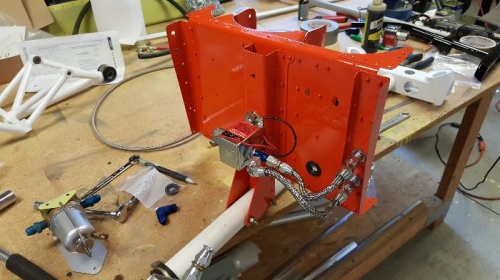

Brief Description:  Firewalls
Decides to replace the rubber fuel lines that come with the kit with PTFE (Teflon) stainless braided fuel lines. These lines are pretty much lifetime. Mounted the electric fuel pumps, pass-thru fittings and electric prime valves to the firewalls and began making the fuel lines.
