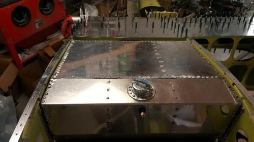

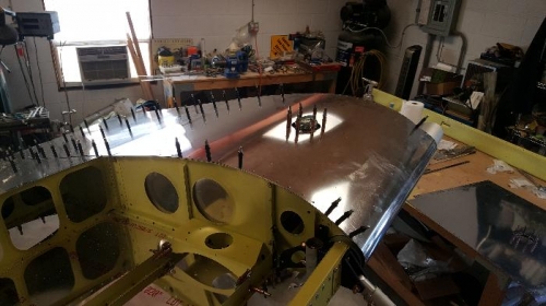

Built new flap motor support braces. the originals were about 1/16 too long too allow the skins to line up.
Added the additional holes on the trailing edges of the lower center section skins.
Installed the fuel tanks in the wing center section. Needed to make additional shims to get the required snugness.
Right fuel tank
Right fuel tank
Left tank with top skin clecoed on.
