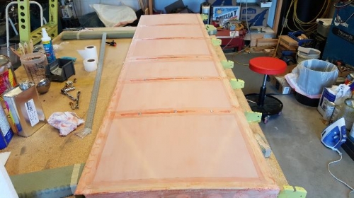

Date:  5-28-2016
Number of Hours:  7.00
Brief Description:  Right verticle stabilizer
Covered the right stabilizer and shrank the fabric. Applied the first coat of Polybrush. Laid out the lines for the finishing tape. Brushed on a second coat of Polybrush where the finishing tapes go.
Right stabilizer with fabric shrunk and  first coat of Polybrush

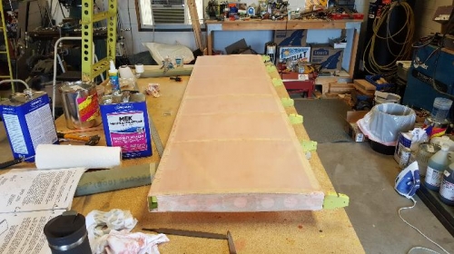

Right stabilizer ready for finishing tape
