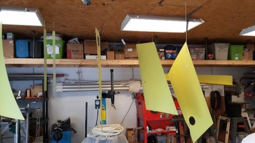

Had to replace the verticle spar doublers (VS002A) due to the factory mis-installing/drilling them.
Reprimed the stabilizer skins with Akzo-Nobel epoxy. This primer works and sprays very nicely! Also primed the new spar doublers.

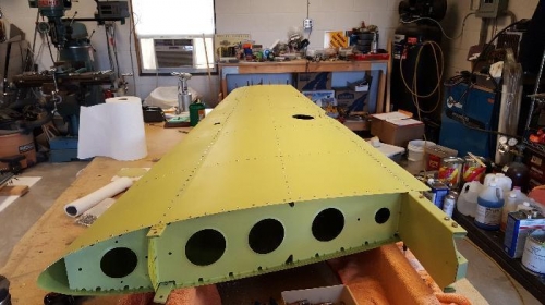

Finished riveting 3/4 of the skins on the stabilizer.
Stab skins primed again
Left side riveted
Left side riveted
