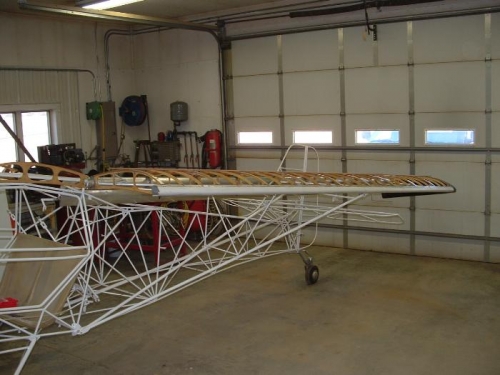

Date:  3-31-2006
Number of Hours:  5.00
Brief Description:  Left wing tip
Installed and rivited the left wing tip in place. Installed the wing on the fusalage and adjusted the flaperon horn. Seems to be a wrong dimension on the horn drawing. Changed the dimension to read 5 3/16" from the center of the hing and now we have clearance for connection to the flight linkage.
Left wing re installed
Second shot of left wing folded
