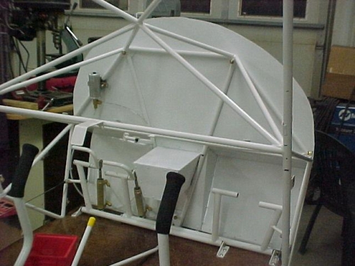

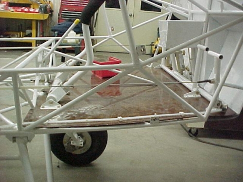

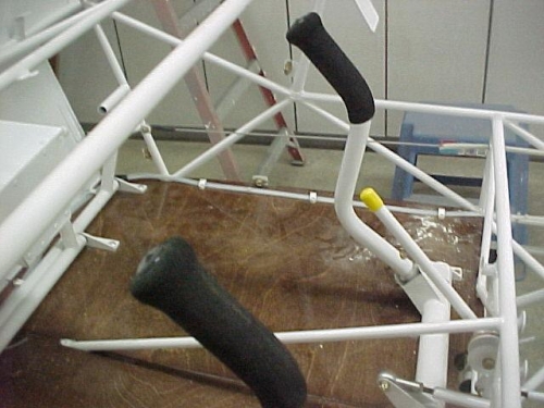

Brief Description:  Hook up breaks and reinstall firewall
Installed break fluid resivoir and hook up break lines. Routed lines to rear of landing gear and tied down to floorboard. Reinstall firewall and rivet in place with monel 3/32 rivets. Installed motor mount and torque all bolts to 60 in #.
Brake line routing
Brake line routing
Brake line routing
Brake line routing
Hook up of reservoir and cyl.
