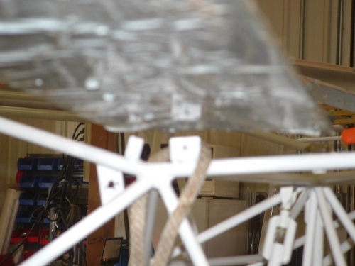

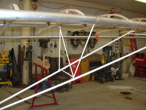

Installed both flaperons with cleco's and checked for fuselage clearance. 1/4 " in both cases. Installed and lined up Left Jury Strut and clamped in place. Checked for wing warp consistance after installing Jury Strut. Still OK.
Left Jury strut installation

Flaperon Clearance
