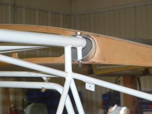

Brief Description:  Fit and drill wing spar pins.
Alinged face of front spar and checked tip to mid hinge on vertical stablizer. Both side 208". Drilled and reamed the hinge pin and front connection. Rechecked the wing wash out and found both sides just outboard of the lift strut attachements identical. Rechecked the wing fold back all looks good
Right Rear Strut pin.
