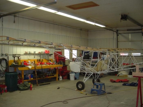

Brief Description:  Fit wings to fuselage
Installed right wing and fitted to mounts. Factory lift strut mounts had to be relieved to allow clearance for rotation both for and aft. Fitted left wing and checked wing warp at the lift strut mounts. Both wings have identical warp. Folded both wings and was pleased with match up. Move smothly with no apparent buinding.
Both wings inplace
Both wings inplace

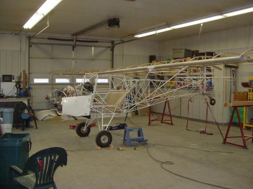

Rear view
Rear view

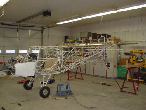

Wings folded.
Wings folded.
