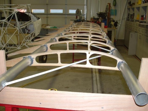

Prep the left wing for final assembly. Clean all surfaces and install bracing. Double check the warp and determined that we have a 1 3/4" wash out at the tip. Fitted the flaperon to the mounts and determined that rip placement is correct.
Left wing less straps

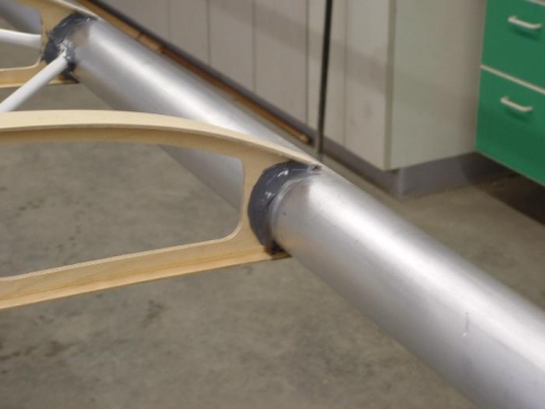

Typical Epoxy joint
Typical rear joint
