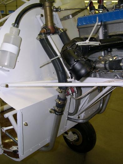

Installed fuel lines and fireprof coverings. Machined a dimpling tool for 1" water line and bent 90deg fitting for return side of system. Relocated the Right side radiator line to dirrectly below the filler inlet and ran hose to complete piping on the suction side of the water pump. Discussed the fireprof covering on the fuel line with Dave Netzer and will remove the tie wrap ends and replace with SS clamps. The dimpling tool worked great will build one for 5/8" heater lines.
Relocated radiator hose
