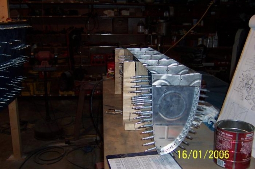

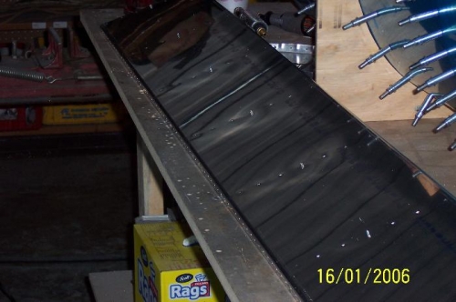

Worked on the fuel tank the whole time. Fit all the ribs, cut stiffeners and drilles them to size. Drilled the mounting z brackets and clecoed them to the tank baffle. Next week will fit the tank to the wing and back drill the z brackets to the rear spar.
