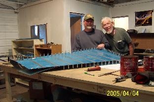

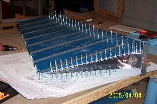

Date:  4-4-2005
Number of Hours:  7.00
Brief Description:  More work on the rudder.
I back riveted the stiffeners to the skin. I assembled the skeleton and match drilled all holes. I made the shim that goes between the rudder horn and rib. I attached skins to the skeleton and match drilled everything. Basicly everything has been assembled and match drilled. I have disassembled everything and am ready to dimple, debur and primer all parts before final assembly.
