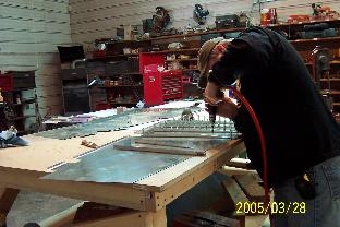

I worked on the stiffeners first thing. I had sanding to do on them that I didnt get finished last week. After they were sanded, I match drilled them to the skin. I then deburred the the holes in the stiffeners and skins, dimpled stiffeners and skins, cleaned all parts and finally primed stiffeners and skins.
this worked well drilling and clecoing to the table
