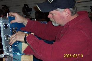

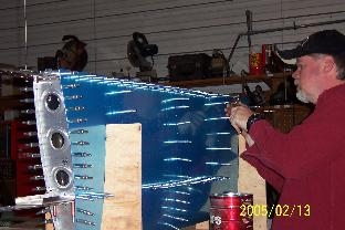

Match-drilled skin to skeleton
I match drilled all of the skin to HS holes in the skeleton. Disassembled everything and deburred the skeleton holes. Used a solder gun to clean the strips of plastic away from the holes on the skin.
