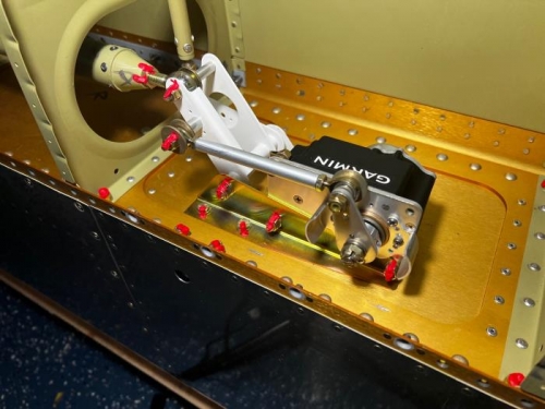

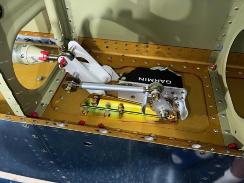

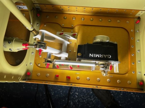

Brief Description:  Hooking Up Garmin Roll Servo in Wing
I printed out the instructions from the G3X manual and installed the GSA28 roll servo for Auto Pilot. I had to remove the lower bellcrack bracket and install the Garmin braket in its place. The hole for the servo control arm was already drilled. I didn't torque anything yet because I have to finish the right flap to get everything mounted and lined up before finishing up the final torques!
GSA28 is mounted inside right wing just outboard of the torque tubes.
