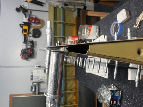

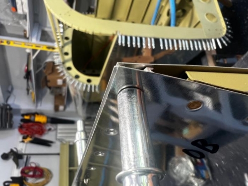

Brief Description:  Aileron trailing edge Clecoed ready for riveting
I clecoed the aileron trailing edges and did not know if it was correct. I took a few close up photos of the trailing edges and did not know if the 1/16" VA-140 was suppose to protrude aft of the skins??
I called Vans and also posted on VAF. This is normal and some other builders left it like that. Vans told me I can file it down nice and smooth before panting.
left trailing edge sticking out past skin
