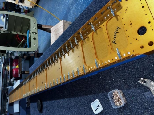

I spent a good half of the day setting rivets to secure the nutplates in the wing spars. The grey primed areas are the doublers for my ER fuel tanks extending outboard 2 rib bays.

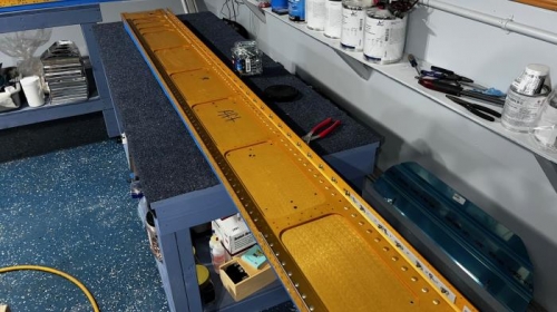

I used the pneumatic squeezer to set these nutplate rivets.

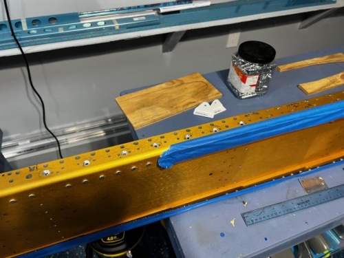

I began countersinking the fuel tank attach holes for ER tanks. These holes remove a chunk of material from the main spars.....but ya' gotta' do it!
right spar nutplates clecoed
completed right spar nutplates
countersining main spar
