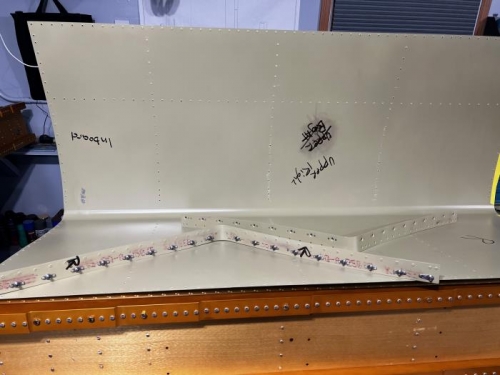

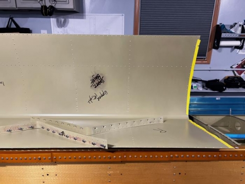

Dimpling LE skins
Used the pneumatic squeezer for the outside holes as this was much faster than DDRD2 press. For the holes my 3" yolk could not reach I used the DDRD2. All dimples look perfect:-) No "oopsies"
