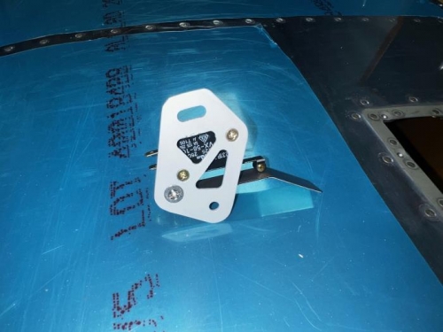

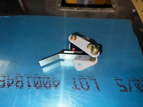

Took on the task of getting the stall warning system installed in the left wing leading edge this evening. I countersunk and drilled holes in the brackets then after priming I assembled the system.

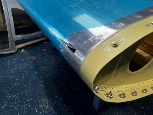

I had to slightly modify the pane sticking out of the leading edge. Pane has to be 90 degrees relative to the wing. The switch has to activate and deactivate within the cutout of wing.
When a stall is going to occur the pane is pushed up sounding a very annoying alarm in the cabin.
I do not know how accurate it will be but worse case scenerio I can always remove it and fill hole with fiberglass and filler before painting. It will be like it it never was there.
Picture is of bottom side up.
