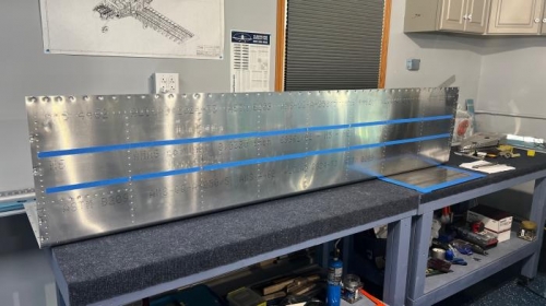

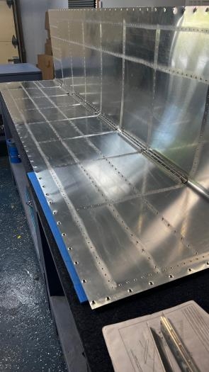

Brief Description: Right Fuel Tank Taping Rivets for Back Riveting St
I began construction on the right ER fuel tank. I started by taping the rivets in place for the stiffeners to be back riveted. I scuffed the inside of the skin where the stiffeners will be located and bonded to the skin,
