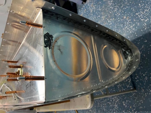

Brief Description:  Outboard Fuel Tank Rib and test fit baffle

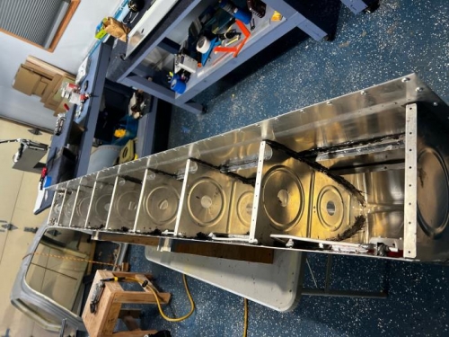

Prosealed the hell out of the outboard left tank rib. I globbed it in the inside so there will be no way anything will escape. So far I have used 1.25 cans of proseal. With these being the ER tanks I will probably use a little over 3 cans after everything is said and done,

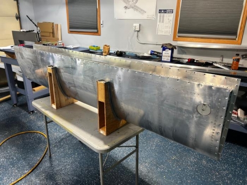

Some additional pics of the near completed left ER fuel tank.
All I have to do now is the rear baffle.
