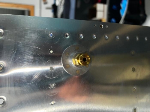

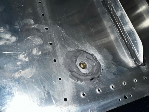

I prosealed and installed the fuel drain flange on the left tank skin. For a second I did not know how this went on the outside of the skin? I first though this went on the inside of the skin....but I figured it out after looking at the plans again.
I used the pneumatic squeezer to set the rivets. I torqued the fitting with a little proseal on threads. I then cleaned up the mess with acetone.
Easy peasy!
left tank fuel drain
left tank fuel drain inside
