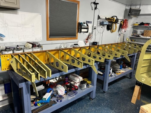

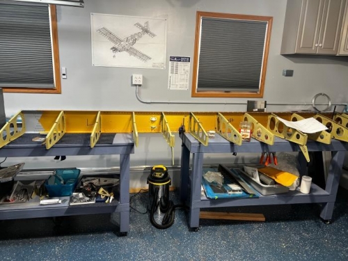

Today I completed riveting the ribs to the main spar both left and right were done.
I know each step of the assembly has both left and right. What works great for me is doing the same for both sides before moving to the next step. Regardless if I think it is a pain in the *ss or not it seems to be the easiest way for me to get things done.
I dimpled everything and primed as you can see in the pictures. On to the skins finally:-) Wings finally taking shape.
