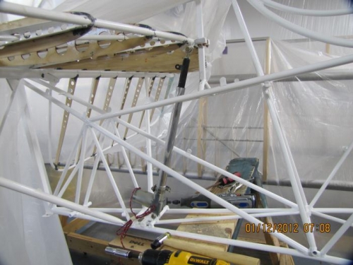

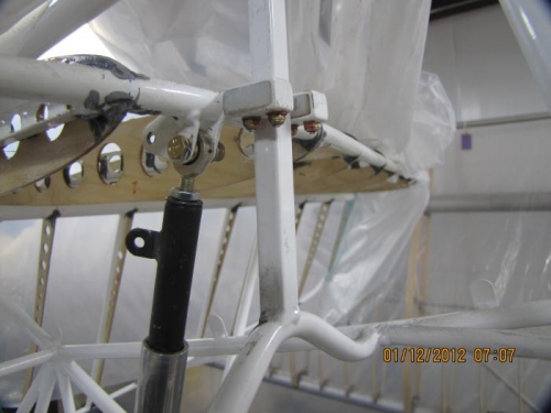

Brief Description:  Install Trim Actuator
Had problem installing the pushrod to the horizontal stab. The bolt and nut combination will not withstand the torque values supplied by the factory. Called the factory to report the situation, was instructed to use another nut with higher torque values. Everything is now fine, and works properly.
Trim pushrod installed.
Complete Actuator visible.

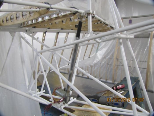

2nd angle of Actuator.
