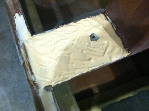

Brief Description:  Leveling the harness attach points
The previous builder did a great job on the layups where the pilot's seatbelt attach points are, however they didn't turn out very level. The last thing I want is uneven or wavy lines on my airplane so I've added wet micro to both sides and will be sanding them smooth to match. Attention to detail will make this airplane stand out among the rest.

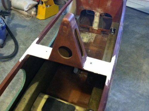

Update: picture #2 is the second coat After sanding the first and noticing low spots.

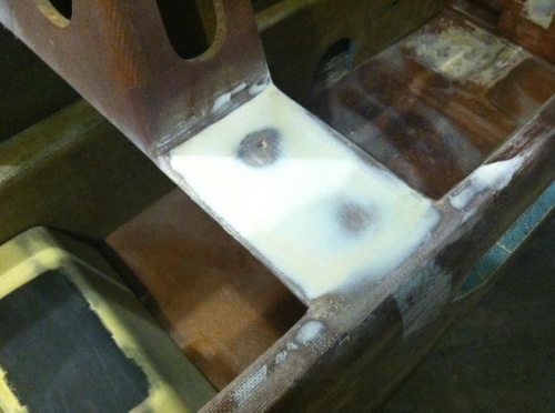

Update: Picture #3 is the second coat sanded and contoured
first coat of micro

second coat
