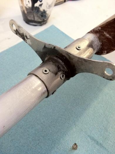

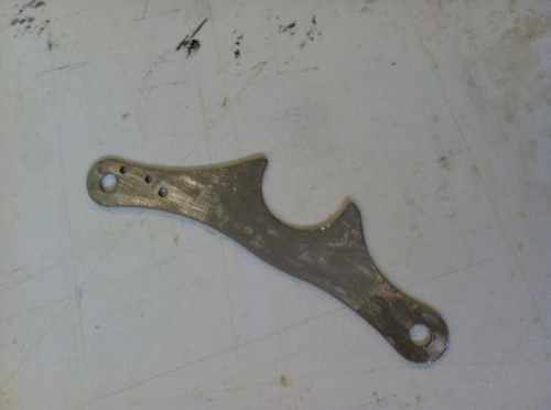

The area of focus tonight is the trim tab that is connected to the torque tube. This tab was welded on wrong, causing me hours of frustration on setting up the trim system. I have decided to remove the trim tab, clean up all the aluminum and steal parts and re-bond them including all new rivets.
trim tab removed and sanded

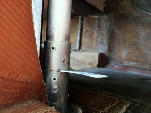

tab re-aligned to correct position
"trying" JB Weld....we'll see.
