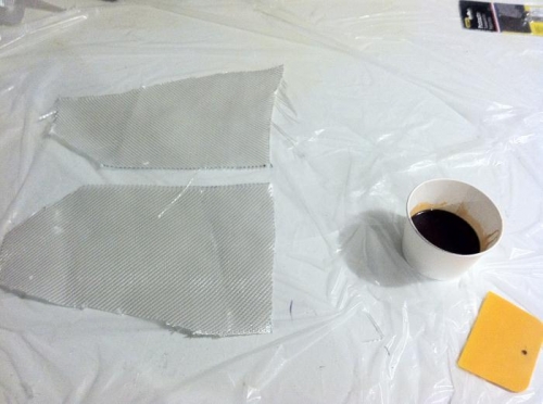

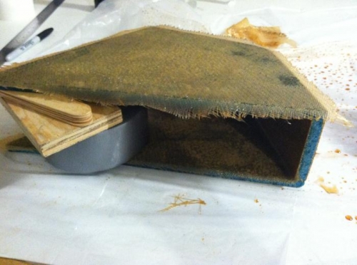

Gravity is an enemy to layups like these. originally I was going to glass the inside walls first but quickly found out that they would not stay put in a vertical position to cure. This lead me to do one BID layer on the outside and 1 layer inside. I will do this again to the other sides after these cure.

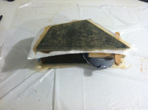

Update: Picture 3 shows the other side BID layer curing.
