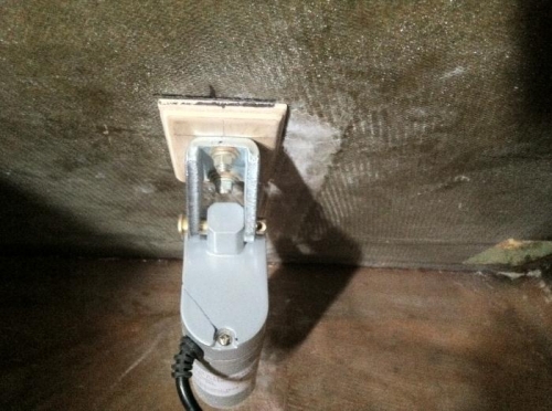

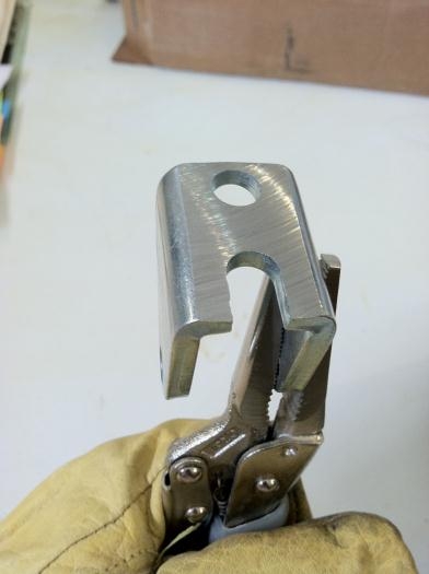

First I ground down the bracket to a flat surface for more stability. I then trial fit everything and found I got a great fully closed and 60 degree angle extended opperation. Finally, I floxed the block in place and after curing I will add 2 layers of UND to complete the mount.
