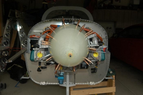

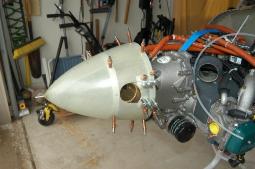

Adjusted track of spinner as per Steps 1-3, page 47-04.
Match-drilled all spinner to spinner plate holes and gap fillers as per Stpes 1-6, page 47-05.
Fabricated gap filler back plates, installed all nutplates, and installled spinner. Torqued hub mount bolts but left propeller blades off in preparation for cowling installation.
