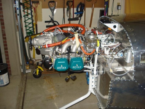

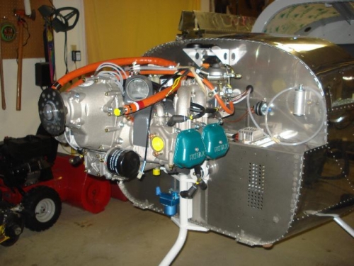

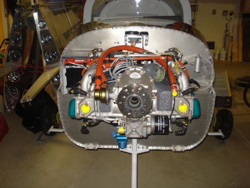

Date:  4-11-2010
Manual Reference:  46-10
Brief Description:  Engine Installation
With the assistance of Mike and Paul Sojka, instllaed the engine as per Steps 4 and 5, page 46-10. Torqued engine mount nuts per specs. Some interference between outer aspect of upper mount washer and engine mount. Found that other builders had experienced similar issue and confirmed with Vans that grinding a recess on the edge of the washer to provide clearance was fine.
