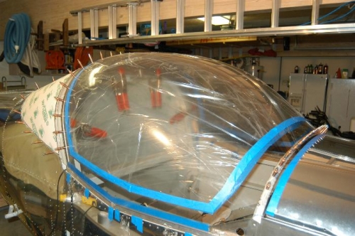

Date:  2-12-2010
Number of Hours:  7.00
Manual Reference:  34-05, -06
Brief Description:  Canopy Fitting

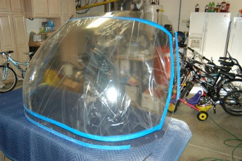

Began fitting and trimming canopy as per Steps 2 and 3, page 34-05. Edges sanded with sanding drum in die grinder, followed by 80 grit sandpaper block, 220 grit sandpaper block. Edges then trimmed with plexiglas edge tool to round and bevel, followed by wet sanding with 600 grit sandpaper to produce a final, smooth edge.
Drilled front bow as per Step 1, page 34-06. Refitted canopy and drilled front of canopy into front box and back of canopy into rear bow with a #30 plexiglas bit as per Step 3, page 34-06.
Fit canopy skirts and match-drilled them to the canopy frame.
