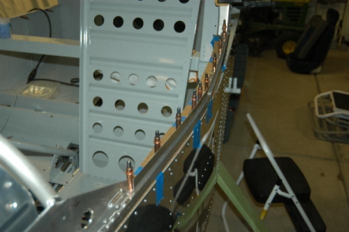

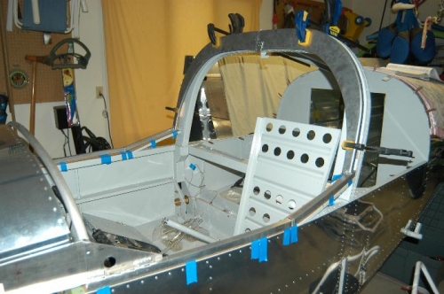

Deburred canopy fram, C-1203A&B, and C-1215.
Installed gas struts and latch handle stop as per Steps 1-3, page 34-02. Measured, marked, and drilled fwd attach angles as per Step 4, page 34-02.
Trimmed and fitted cardboard to fuselage canopy deck. Installed canopy frame to fuselage. Made small adjustments to canopy frame alignment after clamping to roll bar by bending.
Fluted attach angles, match-drilled to canopy frame, deburred frame and angles, and riveted angles in place as per Steps 1-3, page 34-04.
