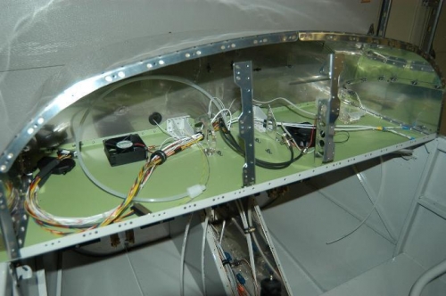

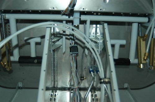

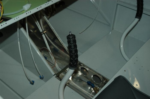

Performed final install of control sticks and wiring as per pages 31-11 and 32-05.
Routed PTT wiring, installed ground wire terminals and secured ground wires as per page 31-11.
Installed over rudder wireway and organized wire bundle around rudder pedal location as per page 31-13.
Reinstalled rudder pedal assembly and torqued to 25 in-lb.
Finished installation of pins in 37 pin d-sub and installed backshell.
Installed 9 pin d-sub on data line and installed back shell.
Installed ELT bracket.
