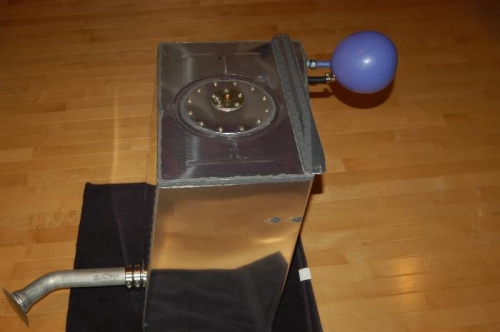

Leak tested fuel tank using the balloon method. No leaks evident using soapy water on all seams. Balloon held size for 24 hours.
Started installation of cowl duct seal.
