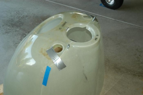

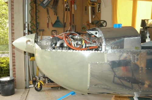

Match-drilled cowl top and bottom fronts and clecoed together.
Cut slots in cowl bottom for nose gear leg, exhaust pipe, and fuel strainer access.
Fabricated all cowling hinges and pins.
Marked hinges for drilling.
Drilled side hinges to cowl bottom.
