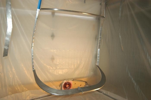

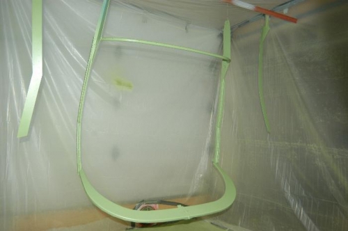

Primed and Painted Canopy Frame
Finished prep of canopy frame and skirts and cleaned with acetone.
Primed canopy frame and canopy skirts with ANAC 2 part epoxy. Allowed primer to dry for 2 hours.
Painted canopy frame, canopy skirts, and ELT antenna bracket (previously primed) with Imron 72092X Gray.
