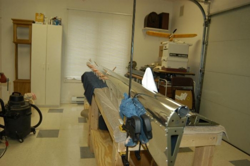

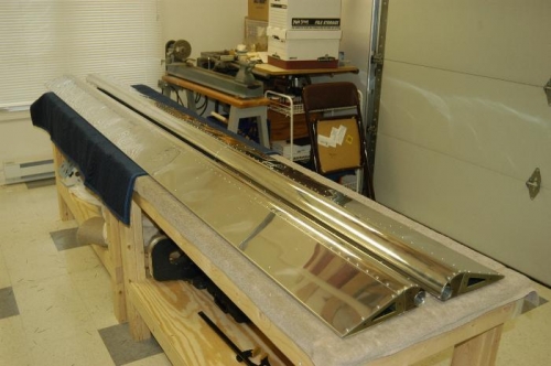

Deburred edges and holes of A-1201C-R nose skin and riveted as per Step3, page 18-06.
Deburred edges and holes of A-1201C-R and A-1201B-R nose skins and riveted to left flaperon understructure as per Steps 4 and 5, page 18-06. Inserted rod end bearings into right flaperon pivot brackets. Right flaperon completed.
Total time for completion of wings and flaperons 121.25 hours (excluding time for review of construction manual and builder's log entries).
