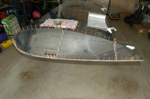

Finished deburring right wing tip parts. Clecoed and riveted W-1213-R, W-1204-C, W-1204G-R, W1204B, and W1204A-R as per Figures 2 and 3, page 17-05. Clecoed and riveted W-1204F-R as per Figure 4, page 17-05. Fluted F-1204E-R to match the outboard edge of the wing tip fwd skin. Clecoed and riveted F-1204E-R as per Figure 5, page 17-05.
Test fit, clecoed, and riveted right wing tip close-out, W-1204D-R as per Figure 3, page 17-06. Deburred and test fit wing tip trailing edge, W-1204H-R as per Figure 4, page 17-06.

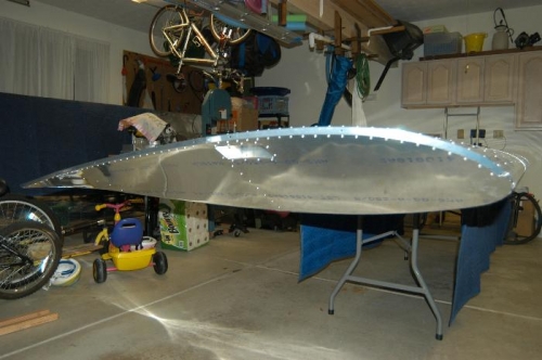

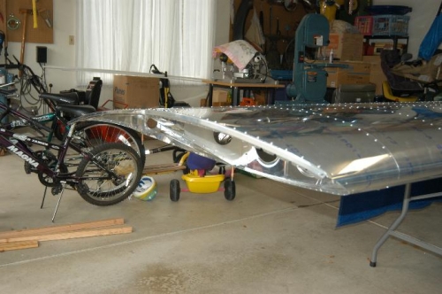

Checked that W-1204H-R was parallel to trailing edge of wing. Match-drilled and riveted wing tip trailing edge. Right wing complete.
