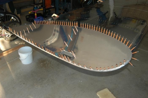

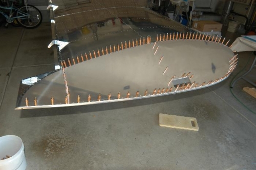

Finished riveting F-1204E-L. Test fit, clecoed, and riveted left wing tip close-out, W-1204D-L as per Figure 3, page 17-06. Deburred and test fit wing tip trailing edge, W-1204H-L as per Figure 4, page 17-06.
Deburred right wing tip close-out, W-1204D-R.
