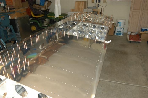

Right Wing Skins
Completed riveting of W-1201B-R inboard upper wing skin.
Deburred edges and holes of W-1203B-R outboard upper wing skin. Clecoed and riveted skin as per Figure 3, page 17-03.
Deburred edges and holes of W-1202B mid upper wing skin. Clecoed and riveted skin as per Figure 1, page 17-04.
Deburred edges and holes of right wing walk doubler, W-1201C-R. Clecoed and riveted right wing walk doubler as per Figure 2, page 17-04.
