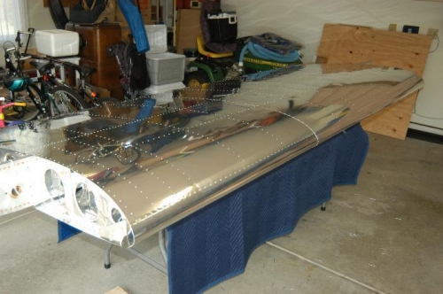

Clecoed and riveted remaining portions of upper skins of left wing as per Figure 3, page 17-04.

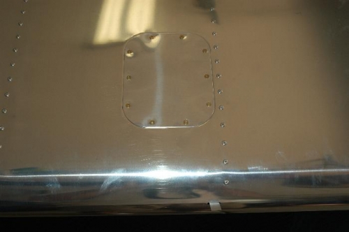

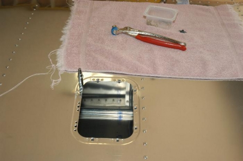

Flipped wing upside down and installed stall warning access hatch, VA-195H as per Figure 4, page 17-04. Left wing done with exception of wing tip which will be installed after right wing has been skinned.
Deburred holes and edges of right inboard and outboard lower wing skins, W-1201-R and W-1203-R. Final-drilled hole for tie down ring in W-1203-R to 3/8".
