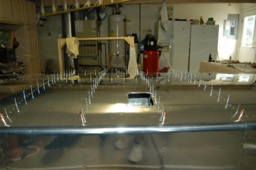

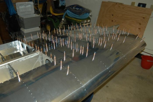

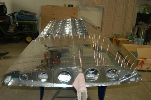

Deburred edges and holes of W-1202-L mid wing skin. Clecoed and riveted skin as per Figure 3, page 17-02. Flipped wing over and clecoed and riveted W-1201-L, W-1202-L, and W-1203-L to top of wing skeleton as per Figure 1, page 17-03.
Clecoed bottom flanges of the two W-1216B-L hinge ribs to the appropriate wing skins, inserted, clecoed, and riveted the W-1216 hinge bracket assemblies as per Figure 2, page 17-03.
Deburred edges and holes of W-1201B-L inboard upper wing skin. Clecoed and riveted skin as per Figure 3, page 17-03.
Deburred edges and holes of W-1203B-L outboard upper wing skin. Clecoed and riveted skin as per Figure 3, page 17-03.
