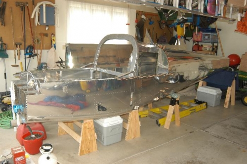

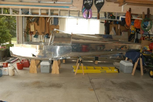

Date:  7-5-2009
Number of Hours:  1.50
Manual Reference:  25-03
Brief Description:  Tailcone Attachment
Today was the big day. Susan, Anna, and Claire helped me move the forward fuselage from the workshop to the garage. After carefully positioning it on the stands built several weeks ago and positioning the tailcone, Susan helped me align skin overlaps while the forward fuselage and tailcone assemblies were brought together and clecoed as per Step 1 and Figures 1 and 2, page 25-03. Also clecoed shoulder strap lugs in place.
