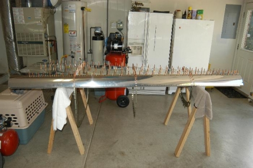

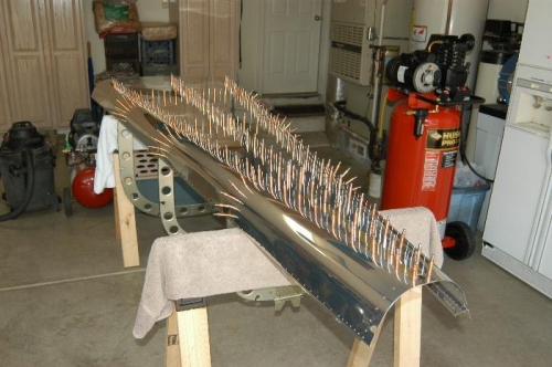

Brief Description:  Tailcone Skins
Deburred tailcone skins F-1280-L&R, F-1281-L&R, F-1282-L&R, and separated/deburred F-1283 J-stiffener. Broke edges of F-1280-L&R, F-1281-L&R, and F-1282-R as per Figure 1, page 10-02.
Assembled bottom skins as per Steps 1-6, page 10-06. Attached F-1208, 1209, and 1210 frames to bottom skins as per Steps 7-9, page 10-06. Clecoed F-1281-L&R skins to frames as per Step 1, page 10-07.
