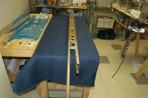

Stabilator Spar Box Assembly
Deburred, fluted, radiused, and primed stabilator ribs and rib clips.
Fabricated hinge stops as per Step 1, page 9-05.
Assembled spar box as per Steps 3-5, page 9-05.
Attached all rib clips and ribs as per Steps 1-5, page 9-06.
Installed hinge brackets and torqued to 25 in-lb and installed hinge stop bushings as per Steps 1 and 2, page 9-07.
