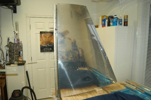

Rudder Parts Preparation
Separated and deburred rudder parts as per Steps 1-6, page 7-02.
Positioned and match-drilled rudder spar caps and deburred holes.
Final drilled holes in the WD-1205 rudder horn.
Checked rudder hinge alignment by temporarily attaching the rudder spar assembly to the vertical stabilizer as per Step 1, page 7-03.
Primed all mating flanges.
Riveted the hinge brackets, spar caps and corresponding rib in place as per Steps 2 and 3, page 7-03.
Removed forward flange from one rudder rib as per Step 4, page 7-03.
