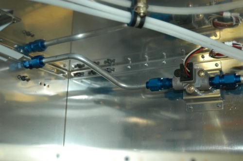

Date:  3-14-2009
Number of Hours:  2.50
Manual Reference:  28-04, 28-05
Brief Description:  Fuel System
Started fabrication of F-1259E fuel line pump-valve but mistakedly cut too short and also deeply gouged pipe at the "S" bend. Hence, will need to order additional 3/8 fuel tubing.
Installed fuel fittings on Flo-Scan and installed the Flo-Scan assembly as per Step 1, page 28-05.
Assembled plugs and fittings to the gascolator and safety wired the gascolator bowl screws as per Step 2, page 28-05. Installed the gascolator to the firewall bottom and torqued bolts.
Fabricated the F-1259C fuel line Floscan-firewall as per Step 4, page 28-05.
