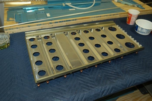

Manual Reference:  26-02 to 26-04
Brief Description:  Seatbacks
Finished match-drilling of seatback hinges as per Steps 12 and 13, page 26-02.
Assembled seatbacks as per Steps 1-8, page 26-03. Missing 2 AN3-4A bolts and some nuts so will need to return to install the hardware in Step 8 after I order replacements.
Hinge pins fabricated for both the seats and the braces as per Steps 1, 2, 5, 6 on page 26-04. Seatbacks temporarily installed in the fuselage. Section 26 completed with the exception of safety-wiring the seatback brace hinge pins, which will be completed after the seatbacks are painted.
