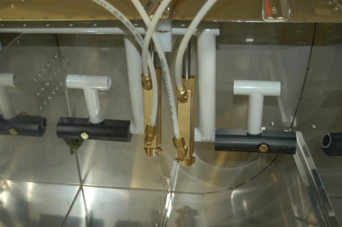

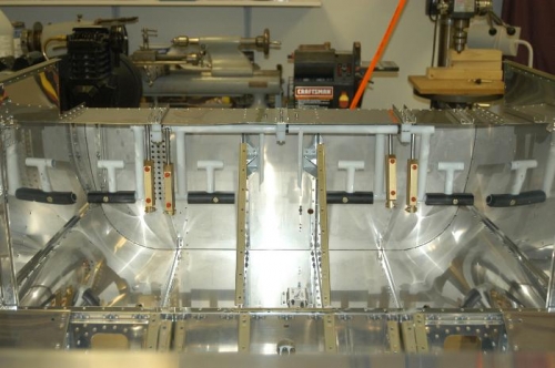

Cleaned and deburred all drilled holes in brake torque tubes. Rudder pedals/brake pedals/brake master cylinders assembled as per Steps 5-7, page 27-03.
Temporarily installed rudder pedal assembly to firewall shelf as per Steps 8 and 9, page 27-03. Bolts loosely tightened, as the assembly will be removed for interior painting.
Installed brake line fittings into master cylinders as per Steps 4 and 5, page 27-04. Fabricated brake crossover lines, main lines, and reservoir lines as per pages 27-04, -05, and -06. All lines installed as instructed on the same pages.
